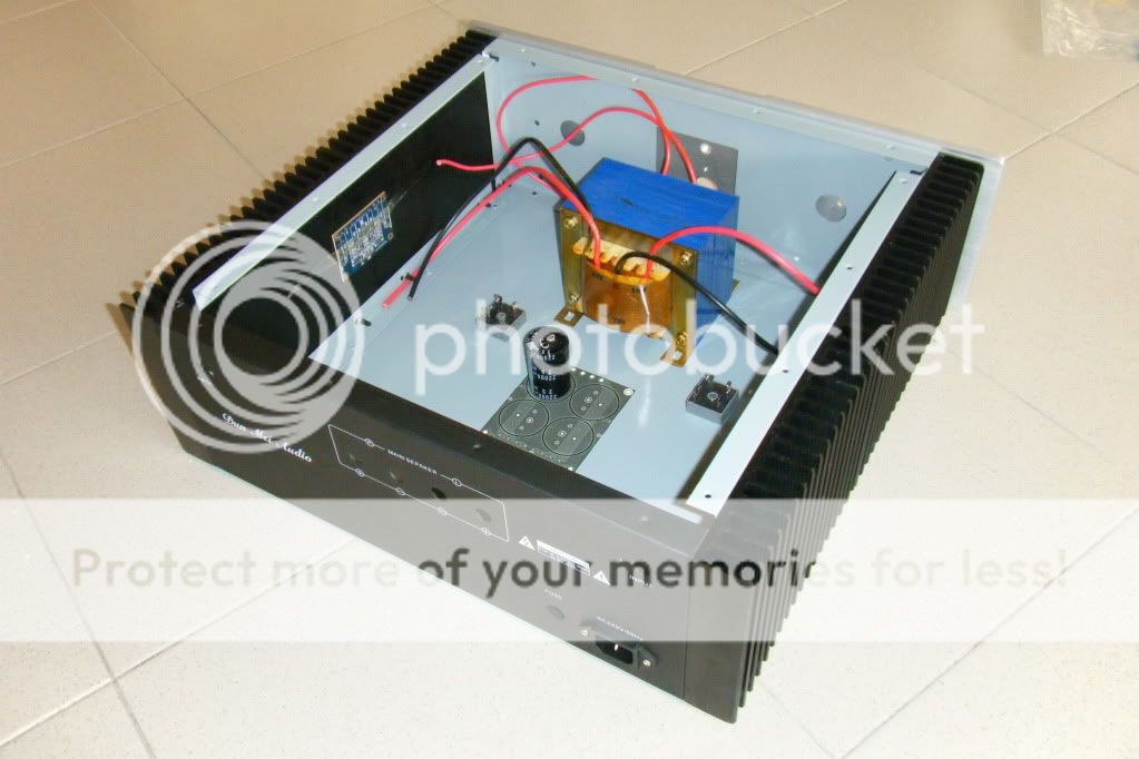

Here is the work in progress on F5.

mthoi wrote:Hi Chua - How is your f5 project progressing? I have just started on acquiring the parts for the pass f5/B1. Perhaps we can compare notes when I have my parts in-place and assembled.
You have your ps board using 8 caps (with 35mm max dia)? I am looking for one. if not I will just solder point to point. I am using Nichicon, could have used RIFA white sausage if not $$$. Most of the resistors I use PRP, Holco. heard Welwyn is good.
the F5 slows as I was building the tda1541a, adding shunt reg to the dac and receiver chips so that I have dual stage regulation. also modding the output stage to pass D1 discrete single ended. will try the charge transfer power supply (works like battery supply, dark background).
Krell KSA50 is a common diy project, and there is a little Krill too. Among the diy amp, passion burns for Pass amp.

Hi Chua, I got the PSU's PCB board from e-bay (Jims_audio). There are 2 stores (probably more) selling Pass f5 parts - Tubeshunter and Jims_audio (do a store search for "pass" of "f5" in e-bay). Tubeshunter has a full kit for the PSU but a bit pricy.
I got the f5 and B1 kit from Jims_audio in e-bay. The f5 comes with all the parts but the B1 is a bare PCB - some effort in sourcing for the parts. Got mine mostly from Parts Connexion. I have not decide on the signal parh capacitors for the B1 - probabally use Mundorf ZN (octave) or Obbligato (diy-hi-fi supply).
I find it cheaper to source for a PSU kit (@RM 70) in e-bay and use the kit's caps (4 units of Rubycon 10,000uf, 50v) for the f5 PSU. That works out to an average of RM17.50 per capacitor - I think it is selling about RM 37 per piece in other e-bay shops.
I am still looking for a enclosure, a 300VA toroidal x'former (25V-0-25V) and 2 heatsinks - prefereably from a local supplier - do you know of any electronic shop that carry these items? Tx

It depends on whether you want to go for dual mono or single. I got my EI 400VA 18-0 18-0 Tx from Multicare transformer from JP and there is another one in Kepong who can do it too.
As for the casing, try PCH 1 or PCH2 from the hifi4sale thread under generic hi-fi chasis. F5 needs a really big heatsink.
I will post some photo shoot of some of the completed F5 by others.

Alas, the transformer for the job should be 2x18V ac on the secondary output. check the correct BOM here.
http://www.diyaudio.com/forums/showpost.php?p=1823039&postcount=103

Chua - 2 secondaries of 18-0, 18-0 is ok. If you need the PSU schematics, PM me.

Powered-up the boards yesterday nite. Made some mistakes and overloaded (turned the bias too high) one channel - probably damaged the jfets since it is immediately hot on power-up. Moral of story - curb enthusiasm and dont work when tired! Ordered new replacement jfets.
The other channel seems to be OK - got the bias going. Will continue testing (with resistor load and cheap speakers) before hooking-up to speakers.

Hi Chua - tx for the 2 pairs of 170/74. I found out that it is one of the MOSFETS that was actually faulty (IRFP240). Ordered from RS and hopefully it can be delivered after Raya. I have made some progress in tuning the bias of both F5 channels using the pair of working mosfets.
The latest development is that I have hooked up the single channel to a pre-amp/CD and a cheap RM35 Pasar Rd speaker. It produces sound - and quite "good" as well! All very exciting!
I would test a bit longer before I connect the F5 to my Harbeth 3PES. I would post some pics when I get the F5 fully up and running.

Hi Guys
For those venturing into the exciting world of solid state DIY amplification modification, a few words of warning would be in order.
It is very important, no... it's absolutely crucial for one to check after performing ANY internal work in an amplifier that there is no DC voltage present at the amplifiers output...i.e. the speaker terminals.
When an amplifier is working correctly, you should be able to measure a varying AC voltage output present at the speaker terminals. But when you measure for DC voltage at the output, there should ideally be NONE.
If there is SOME DC, then what happens is that your speakers voice coils will eventually burn out. You then need to replace your drivers. This can be extremely expensive.
I learnt this the hard way back in the early 90's when I built my first pair of Naim NAP 135 monoblocks. One simple connection error on my part resulted in some DC voltage present on the output of the amplifiers.
I never paid attention to the faint burning smell that could be detected shortly after switching them on as they appeared to be working correctly and everything was sounding great. End result, 5 minutes later I had a ruined pair of Linn Kans which I personally went to the UK to select and hand carry back. But that's how we truly learn.
DC on the output of any solid state amplifier is deadly to your speakers. And headphones too. I hope this will save someone from some misery!
On a happier note, as chua55 says, some new pictures would be most welcome indeed MTHOI

I just completed the F5 after burning 3 mosfets! This is my learning lessons.
AS usual, I was not careful with the trimpot during adjustment. There is not much room for error.
Those building it, please start with the lowest R across the gate and source of the mosfet when you start powering it up.
I bought the chasis from one of the posting here and I wish the heat sink is about 20 % bigger. I have only adjust the bias up to 0.54V . The recommended bias id 0.6 V. After powering up in a non aircon room for 1 hour , the heatsink can only be touched for about 6 seconds.
