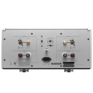

Spec description
Speaker output
Rated output power 145W + 145W (8Ω)
290W + 290W (4Ω)
Maximum output power 580W + 580W (2Ω)
Damping factor 1000
Analog audio inputs
XLR 1 pair
Input impedance 44kΩ
RCA 1 pair
Input impedance 22kΩ
General
Power supply
AC 230V, 50Hz
AC 120V, 60Hz
AC 220V, 60Hz
Power consumption 440W (no signal: 160W)
External dimensions (W×H×D) 445 × 221.5 × 489.6mm
17-⅝" × 8-¾" × 19-⅜" (including protrusions)
Weight 48kg / 105-⅞ lb
Included accessories Power cord × 1
Power cord support bracket × 1
Power cord support bracket screw × 2
Felt pads × 4
Owner's manual × 1
Warranty card × 1
Audio performance
Frequency response 5Hz to 100kHz (+0dB, –3dB, 8Ω)
S/N ratio 115dB (IHF-A)
Total harmonic distortion 0.003% (1kHz, 8Ω, 145W)
Gain 29dB
